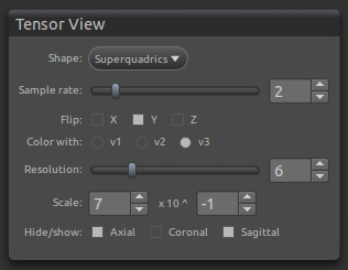

Tensor view toolbox
The tensor view toolbox was created to control the way the tensors are calculated, rendered and displayed. The following parameters can be tweaked:
Shape: Determines the figure of the glyph. Possible options are Lines, Disks, Arrows, Cubes, Cylinders, Ellipsoids, and Superquadrics.
Sample rate: The higher this value, the more spread the sampling will be, hence less glyphs will appear on the screen.
Flip X / Y / Z: By checking or unchecking these checkboxes the respective X, Y or Z axes can be flipped.
Color with v1 / v2 / v3: Choose which eigenvector is used for mapping the color mode.
Resolution: Increases or decreases the amount of detail of each tensor’s glyph. Lower values are preferred for slower computers.
Scale: These two values are used to set the scaling factor for the glyphs, hence, their size.
Hide / Show Axial, Coronal, Sagittal: Hides or Show the respectives planes.

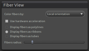

Fiber view toolbox
The Fiber View toolbox alters the visualization aspect of the fibers being rendered. It’s capable of controlling the following:
Color fibers by: Whether the fibers are colored by their local or global orientation or by considering the fractional anisotropy.
Use hardware acceleration: Uses GPU hardware acceleration.
Display fibers as: There are 3 possibilities to display fibers, as polylines, ribbons or tubes.
Fiber radius: Modifies the radius of the fibers (if they are not being displayed as polylines, which are not volumes).
